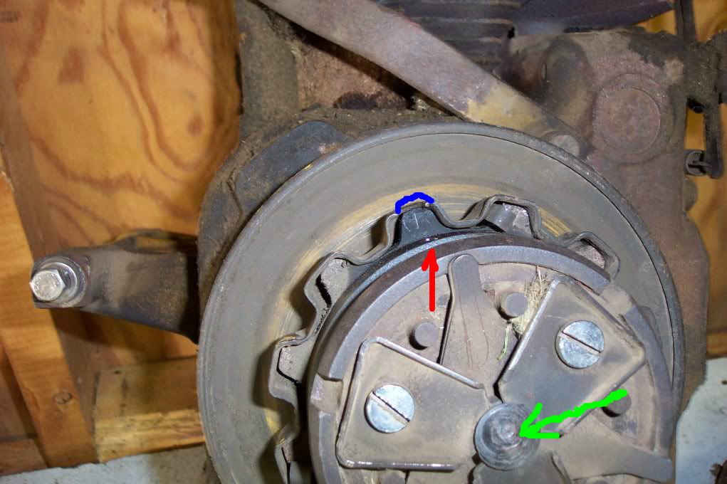

Jeff in Pa 10-08-2014 09:45 PM
Originally Posted by chris hall (Post 290337)
oh shit .i didn't know there were rattle clips involved. you may have cured my problem. where do they go ? i am assuming the go between the basket and the fiber disc ?
Shows one of three to the right of the red arrow. ( equally spaced )
