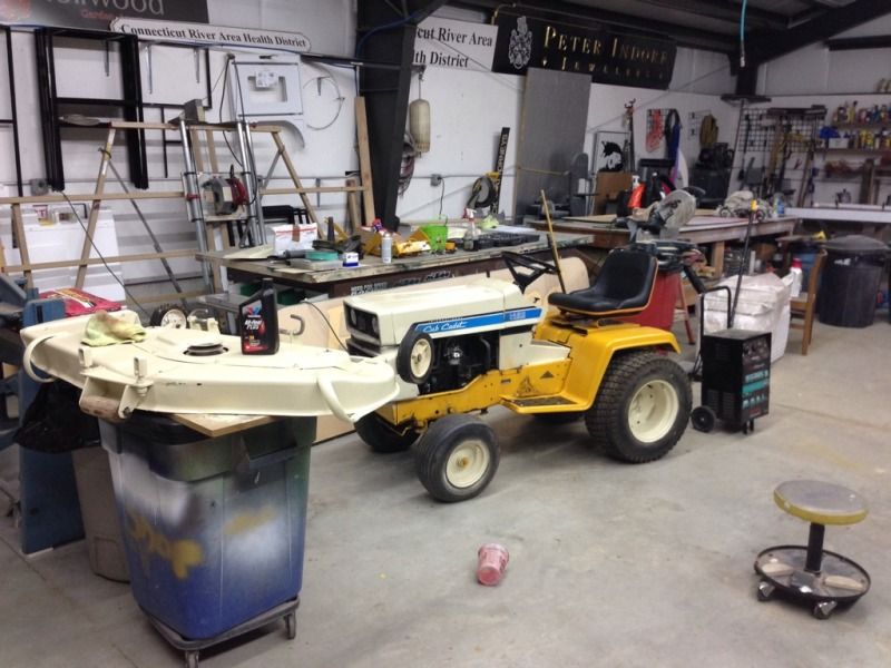

Hey guys i just did an overhaul on my 1450. repainted, new decals (which i make having a large sign and graphics shop), rebuilt carb, new points, new solenoid, new battery, new muffler, new lights, and a few other things i cant think of now.
Well after a long time tracing a short i found one of the connections to the electric PTO was the culprit! took me a week to find it because it was intermittent. Anyways now she cranks over great, i have spark but cant get her running more than a couple seconds. now i cant even get that. I took the carb off again and everything looks good. Before i fixed the loose wire on the PTO i had it running by jumping the solenoid, now i cant get her running. Does the adjustments on the carb make that much difference? Any help is greatly appreciated. here is a before and after pic http://i109.photobucket.com/albums/n...IMG_2710-1.jpg http://i109.photobucket.com/albums/n...2E62FEC8F5.jpg |

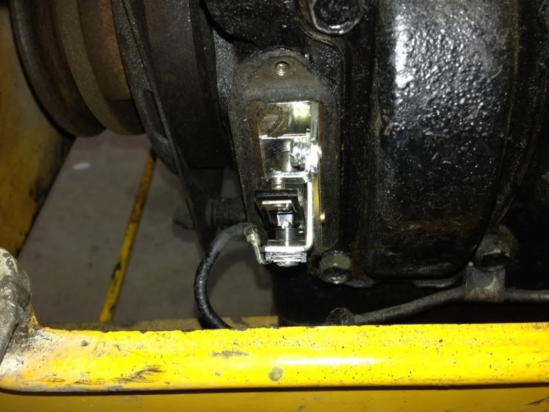

I did not have my multimeter so i just did a eyeball adjustment with a digital micrometer and got her to run. She idles well but stalls as soon as i give it any throttle. I tried adjusting the points 10 times with no better results. I cant find the "S" and "T" Matt talks about in his timing pdf. I also found another issue while letting it run, my hydro lift will not move. It seems like the piston it controls is frozen. I checked the fluid level and it looks to be full and oil looks clean? I tried pushing the piston with a screwdriver. Here is a pic of the points position and the piston that seems frozen. http://i109.photobucket.com/albums/n...CC352A992B.jpg http://i109.photobucket.com/albums/n...CC2E8B5F10.jpg |

Double check your grounds as well. The timing marks can have some light rust on them. Did you rebuild the engine or new points? |
