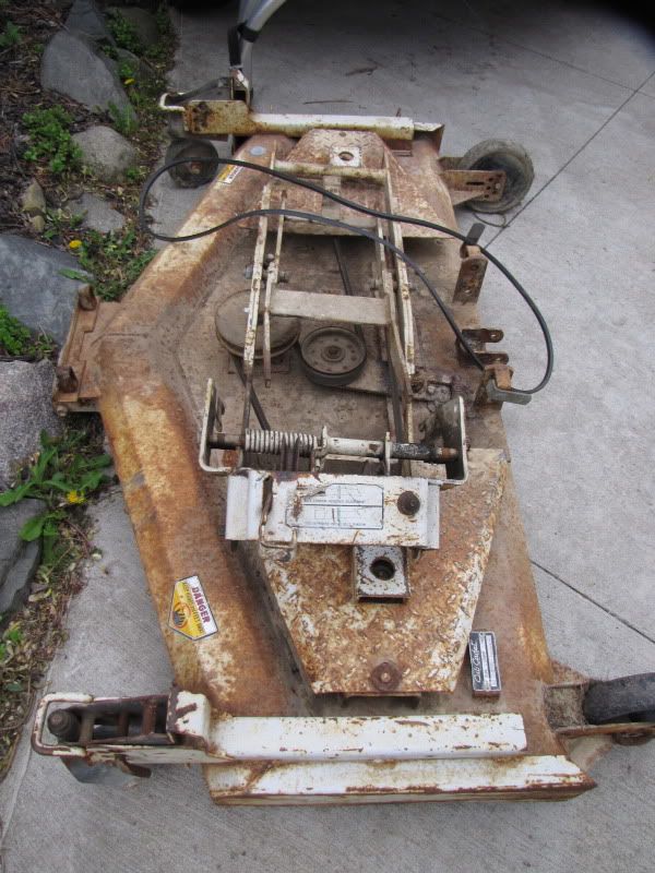

Sam Mac 08-28-2012 06:29 PM
5 Attachment(s)
Ben
The lift arms on yours are bent but I'm sure you know that.
A couple pics of the Haban I just picked up from Chris Westfall. He said the PO was mowing with it but he didn't check it out. My guess is it was not cutting very well LMAO Take a good look at the blades. Other than that issue it's a nice deck. Also attached pics of the mule & lift. This is for the older Habans.
