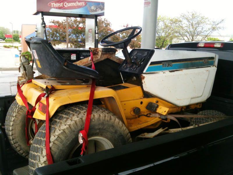

and get pumped up. I begin to shop around for parts. Next I find this 2072 on CL for $400.00. The seller comes down to $350.00
http://i6.photobucket.com/albums/y24...Picture015.jpg
Looking back at the price breakdown on inspectorudy's build, I think I'm on to something? Buy the 2072 for $350.00, take off any parts I want to use on the 782, then sell the rest.

But more than that this, 2072 is rough, it has sat outside most of it's life (last 10 years anyway), it was sitting next to a house fire, seat cover melted, hood ornament looks like a banana! The PO never had the deck off of it?? I had to show him how to remove it, and he owned it 15 years! It runs and drives, but he said it will bogg down in heavy grass, the 20hp Kohler magnum needs attention. They did some "cobbleling" on it. Mostly the wiring, starting it with a screwdriver, the fuse recepticals are gone from the dash, I'm not sure what all they did there?
So for those reasons and more, the 2072 is a parts machine. My question is, what all can be switched over to the 782? The wheels and tires are larger, the frame is longer, but is the sheetmetal the same? If it is, I could do the bodywork on those pieces, get them painted red and all decaled up, without taking the 782 out of service.

As far as interchangeable parts go, all of the sheet metal should work out fine. The tunnel cover is longer. The dash on the 2072 has an extra hole for an oil sentry light, but should be the same other than that. Also, I believe that the battery box under the fenders is taller on the supers due to the larger tires.
The lift is also not the same as the standard garden tractors - so if you have front attachments for the 782, there is nothing standard on the 2072 that will lift it. The mower deck implement lift is the same.
Needless to say, you've got a good start, so you can't go wrong! Let's see some pictures of that 782!
