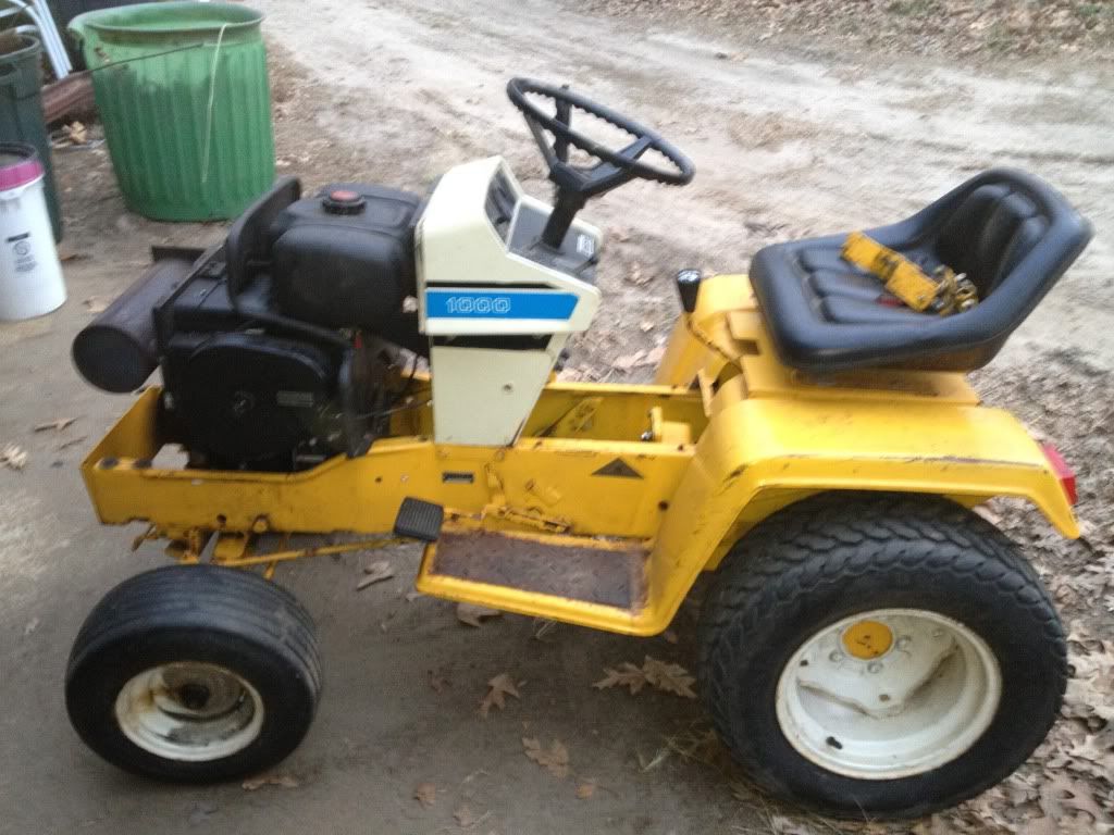

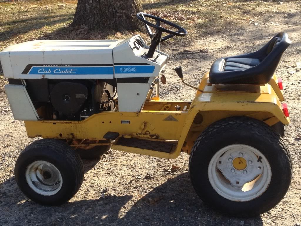

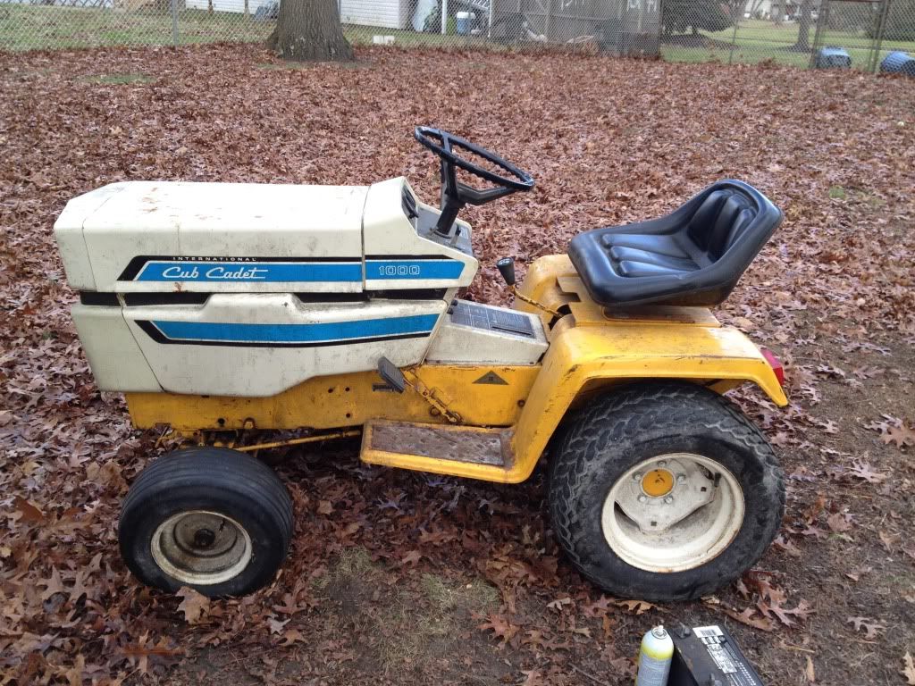

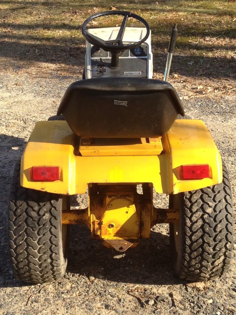

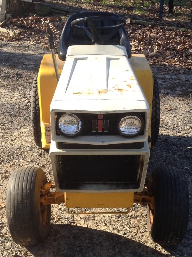

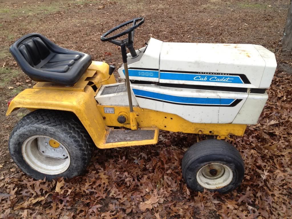

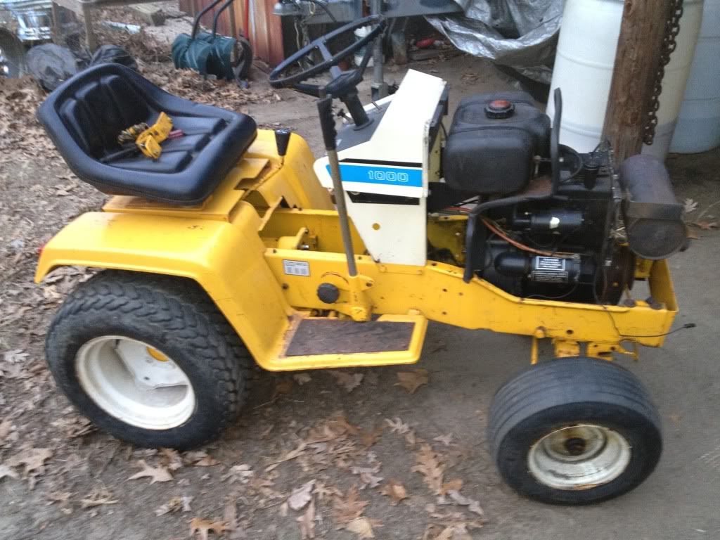

For starters I am new to Cubs... about three weeks ago I picked up this Cub Cadet 1000. I wasn't looking for another garden tractor at the moment, but I was surfing craigslist, and saw it and realized it was only 2 miles away from my house and came with a mower deck, snow plow, and a Peco rear vacuum. So I went a took a look at it. I told the guy after looking it over that, if I could get the engine to run I would take it home with me. Well after running 12v to the coil, and using a jumper on the starter and a spritz of starting fluid she started and stalled. That was good enough for me. The price was definitely right and it is all original. Along with coming with all of the original manuals, paperwork, and service receipts made it even better. I rebuilt the carb, flushed the gas tank, changed the fuel line, cleaned the battery ground point, and she started right up and runs great. When I tried to drive it I was met with a loud grinding/chattering noise and decided to pull the drive shaft cover to find out that the drive shaft is bent. So I have to fix that but otherwise it is a nice sound original unit.Here are some pictures and a video of it running!
Also! Can anyone please tell me what they think it is worth through a PM. I think I definitely got a deal for the price I paid.

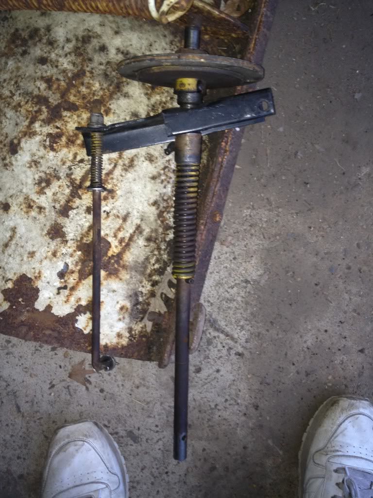

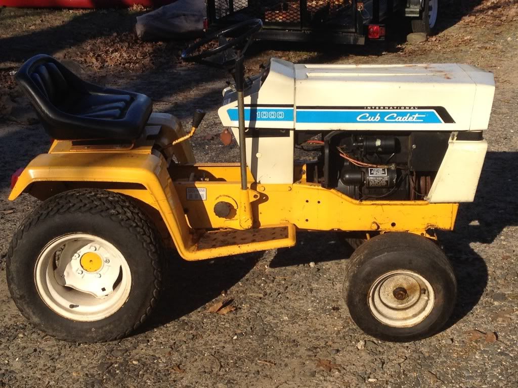

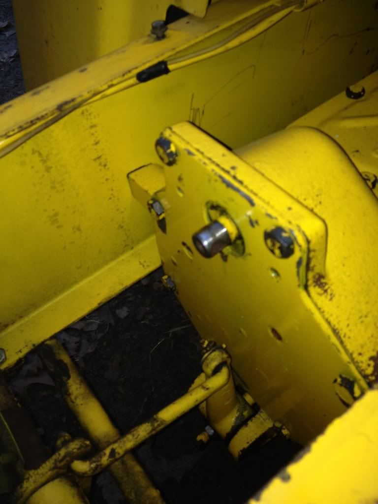

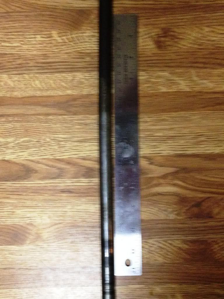

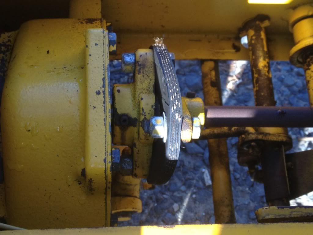

So I pulled the the drive shaft and low and behold it was definitely bent. I also know about the iso mounts. I am replacing them with solid billet one. I also ordered a new hardened drive shaft from Brian miller. I had a friend true up the pressure plates, but he thinks they are too flimsy and he is going to make me new ones (hes a machinist by trade). So when the parts come in I will post pictures until its fixed. I am pulling the engine and cleaning behind the shroud (mouse nest) and then taking off the head to de carbon it and replace the head gasket.
