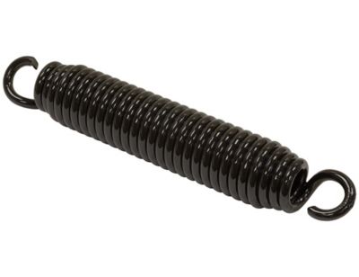

Has anybody ever come up with a home made lift assist?
I picked up one of these at TSC,
http://media.tractorsupply.com/is/im...9094?$cm%5Fio$
and might do some testing of lift assist with it.
I always thought the stock lift assist did not have enough UMPH!!
This one is 0.400" wire so it will have a little more UMPH.
Any other springs been substituted??

The one I found is a truck snow blade spring at TSC for $12.99. I hope to put it on a QL1000.

I've had the same thought in the back of my mind since attaching the blade to my 122. I think it would likely work pretty well if you can get an adjustment nut welded into the end of the spring. :bigthink:
Post pics if you get it set up!

They sell an adjustment bolt that has an eye which slips over the spring end.
5/8" bolt w/eye hole and 2 nuts about $3.

Eureka!!! That's brilliant! I hadn't thought about an eye bolt. :beerchug:
Hope that the spring gives you the pull you're looking for.
