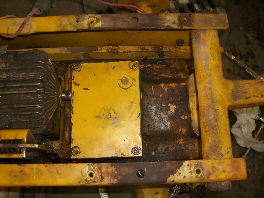

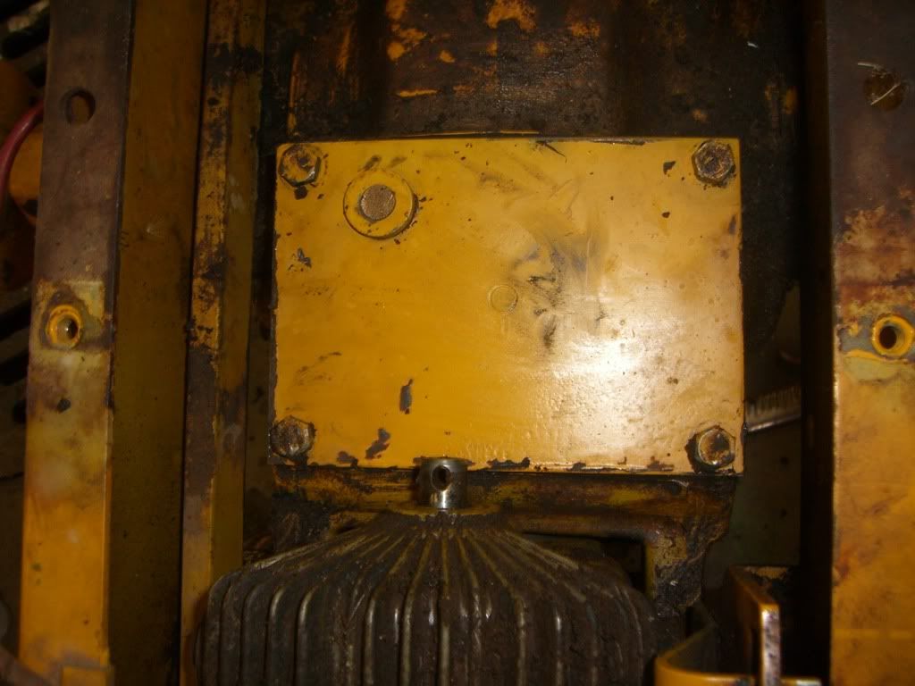

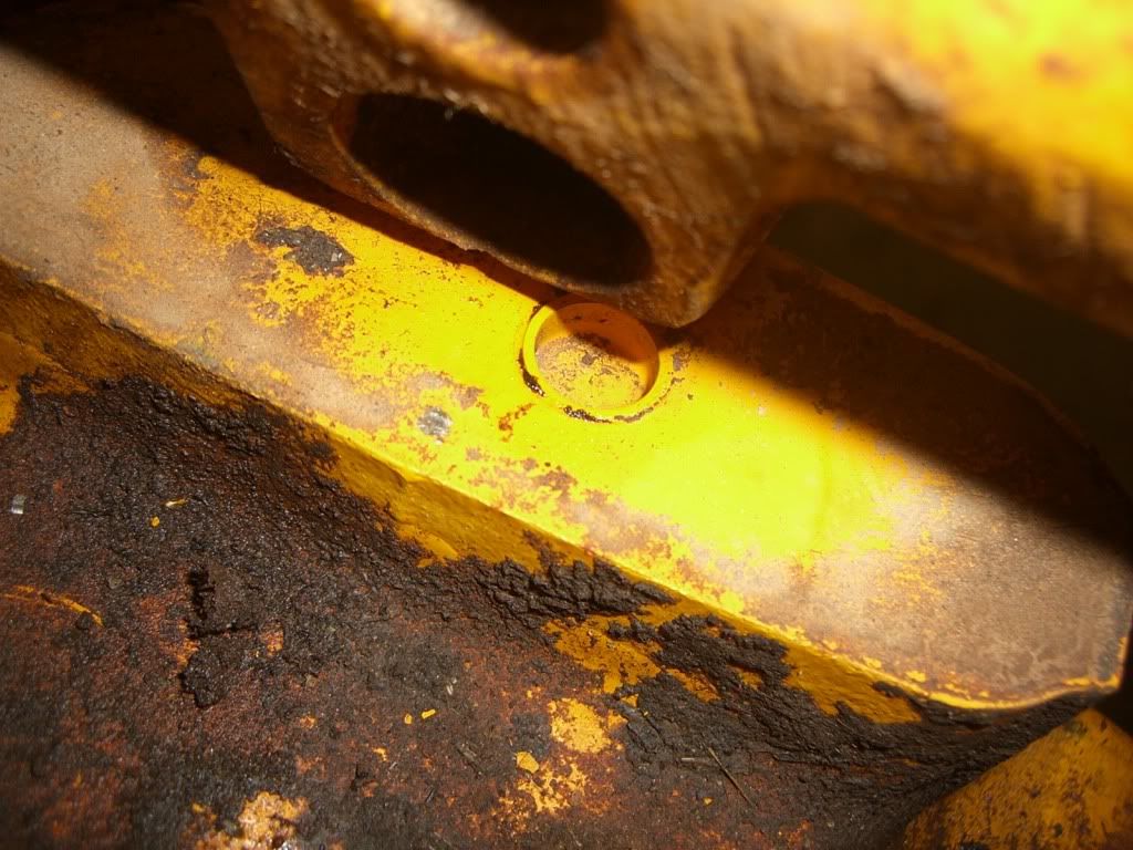

terkaa 07-22-2011 02:05 PM
OK the pics:
1. You can see breather on top cover:
http://i170.photobucket.com/albums/u...0/CIMG1166.jpg
2. You can see instead of a breather there is "blind" plug installed on oval shaped part of rear end casting:
http://i170.photobucket.com/albums/u...0/CIMG1167.jpg
3. Whole setup:
http://i170.photobucket.com/albums/u...0/CIMG1168.jpg
So anyone seen breather installed on top cover like this? And on this pic I have rotated cover so breather is at rear right corner. It was on front left corner earlier but oil bubbled out of it when hydro was running full forward.
Tero

westofb 07-22-2011 08:47 PM
If that is a PO modification, it was done very well....it looks to be factory installed. What does the bung the breather is installed in look like from the bottom side? Thanks for the pics!
