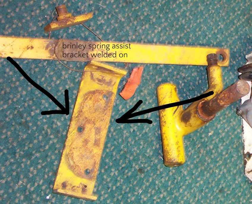

These are the available spring assists for the NF Cub cadets
You have a 122 listed. Since it's a manual trans, you can use both the Brinley spring assist and the IH spring assist on your 122 ( provided you have the rear lift--The Brinley attaches to the rear lift arm )

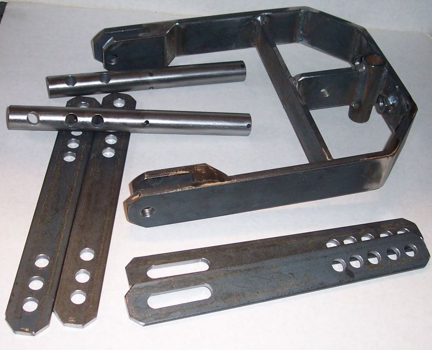

Here is the heavy duty sleeve hitch adapter I make with both drilled and slotted lift straps plus lift pins

Nice hitch, and thanks for the pix.
Is a rear lift the same as a three-point?

Thanks :beerchug:
Yes, as you can see in the picture, the three points are the lifting arm and either side of the U shaped bracket.
