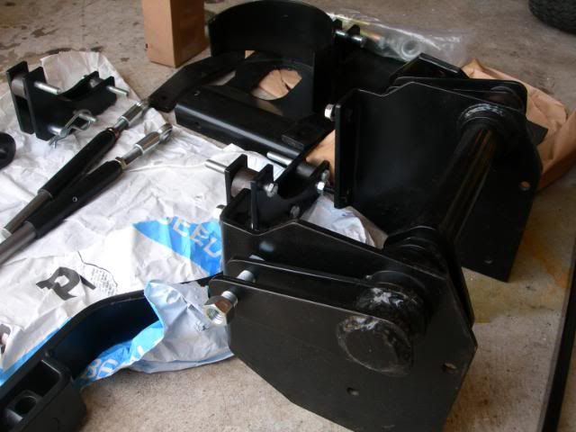

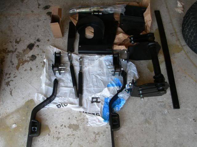

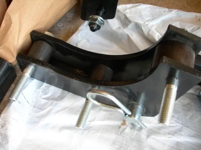

I unpacked the boxes and here's what I found.
http://i133.photobucket.com/albums/q...zini/005-1.jpg
http://i133.photobucket.com/albums/q...zini/006-2.jpg
http://i133.photobucket.com/albums/q...zini/009-1.jpg
http://i133.photobucket.com/albums/q...zini/007-1.jpg
http://i133.photobucket.com/albums/q...zini/010-1.jpg
Powder coated and ready to install. The only piece missing that I noticed on my initial look was the pin that connects the liftbar to the ram. I'll be going thru it with a little more detail after work tonite.
By the way, is the bolt pattern the same for all cast iron rearend plates? ie: will a gear drive rear plate bolt right up to a hydro rear end? The offset of the plug on the gear drive plate looks to be positioned better to fab the PTO plate from.

Yeah, the gear drive and hydro rear cover plates are the same. The only difference is the fill plug location.
ACecil 04-22-2010 01:18 PM
Looks great, toyman! Can't wait to see them on your 982. The bolt pattern is the same for the CI rear ends. The only difference like you said, is the location of the plugs. :beerchug:

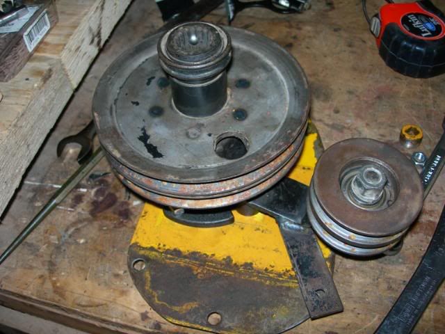

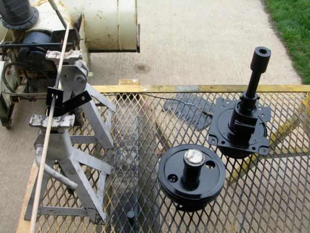

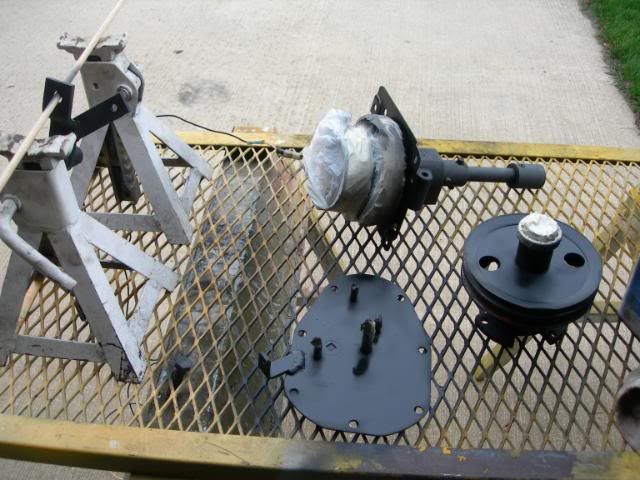

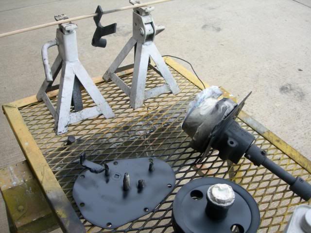

I got the PTO parts cleaned up last nite. I'm going to put a coat of primer & paint on before I install, and I have a few nuts & bolts to pickup to fab up the rear plate, but I have a plan now, so it should take off.

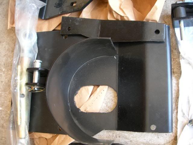

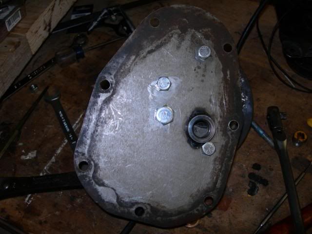

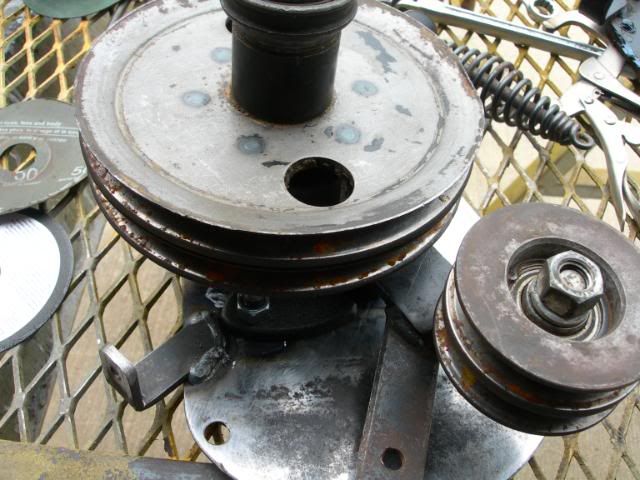

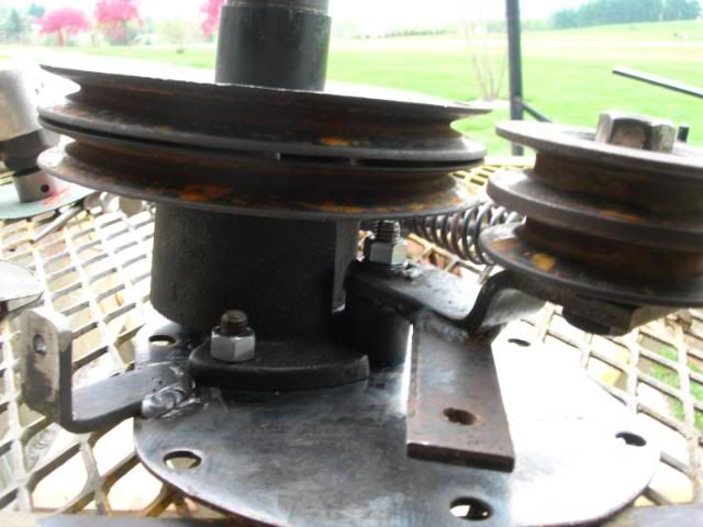

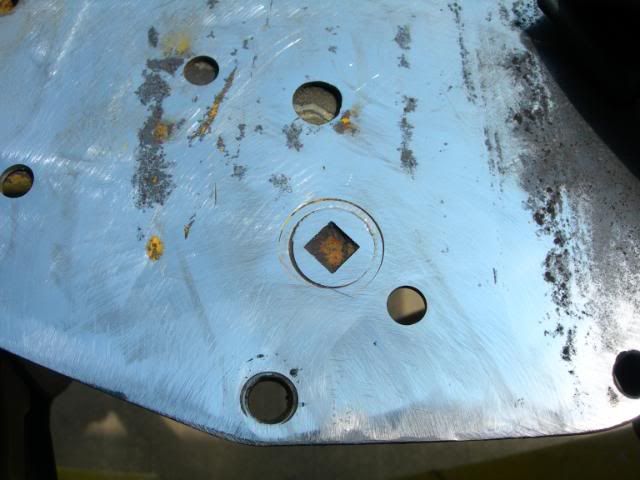

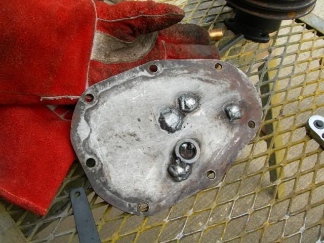

Ok, spent about 2 hours in the shop working on the rear cover. Heres what I have so far.
http://i133.photobucket.com/albums/q...tors/004-8.jpg
http://i133.photobucket.com/albums/q...tors/005-8.jpg
http://i133.photobucket.com/albums/q...tors/006-7.jpg
Need to weld the bolts and figure out how to plug the fill hole (suggestions welcome). Also need to fab and weld on the spring hook.

Put the plug back in it and tack or weld it in. If it's a clearence issue....grind it flush and tack from the interior side.....or install from the inside and weld and grind flush on the outside....just skin'n the cat....

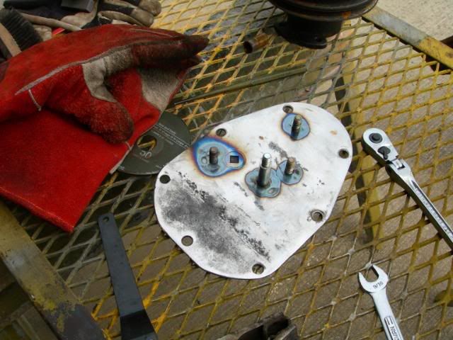

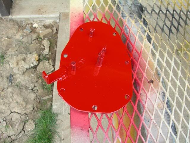

Ground the plug flush and tacked it from the inside. Got the rear plate done, primered and first coat of paint on it and the rear pto. Pics are coming later.
I can't comment on the Extreme hitch. (or the Ruegg for that matter as it's still sitting on the bench!) I just knew that I needed one that would work with the rear pto. I found out about the Ruegg hitch, rear pto and tiller within a day of each other. (The hitch was being discussed on another CC forum, and the pto & tiller were on craiglist)

toyman 04-24-2010 07:27 PM
Good info - thanks Scott.

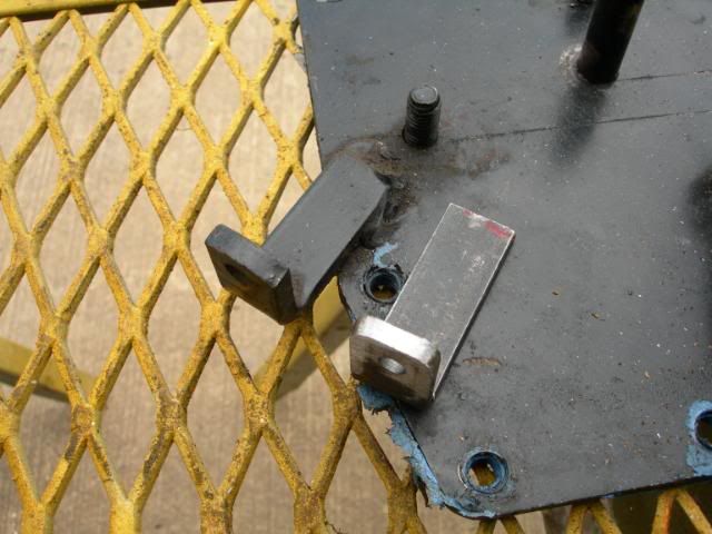

Here's some pics of todays progress.
Plug ground flush
http://i133.photobucket.com/albums/q...tors/004-9.jpg

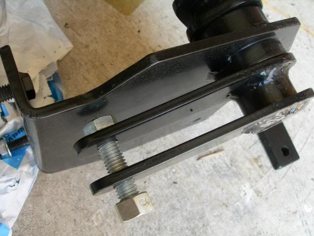

bolts welded in
http://i133.photobucket.com/albums/q...tors/005-9.jpg
I hesitantly show the welds (I'm a businessman not a welder!)
http://i133.photobucket.com/albums/q...tors/006-8.jpg

Broke down for primer
http://i133.photobucket.com/albums/q...tors/013-3.jpg
http://i133.photobucket.com/albums/q...tors/014-2.jpg
Color
http://i133.photobucket.com/albums/q...actors/021.jpg
http://i133.photobucket.com/albums/q...actors/022.jpg

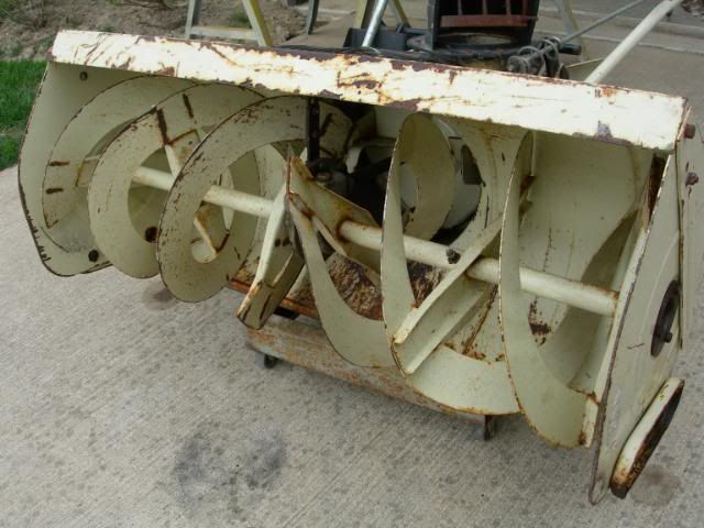

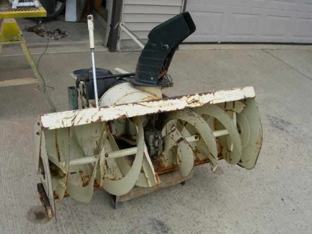

450 blower "Cub Vined" from New York to Plow Day in PA. Not bad for $250?
http://i133.photobucket.com/albums/q...tors/017-1.jpg
http://i133.photobucket.com/albums/q...tors/018-1.jpg
http://i133.photobucket.com/albums/q...actors/019.jpg
The BEST part of the day was the excitement and enjoyment my 12 year old daughter (toygirl) had at plow day (in the rain no less!). She wants to go next year and plow with "her" 1862:biggrin2.gif: A productive and enjoyable day!

My uncle was a welder for 30+ years and I was just starting out welding before he died and one of the things he told me was "your welds ain't always got to be purty but they darn shure better hold".
Scott

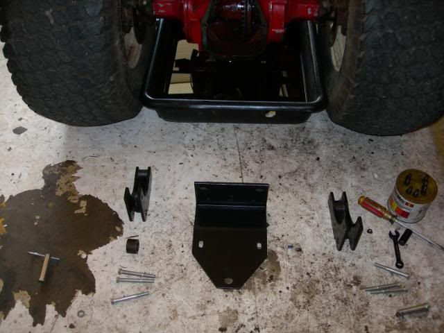

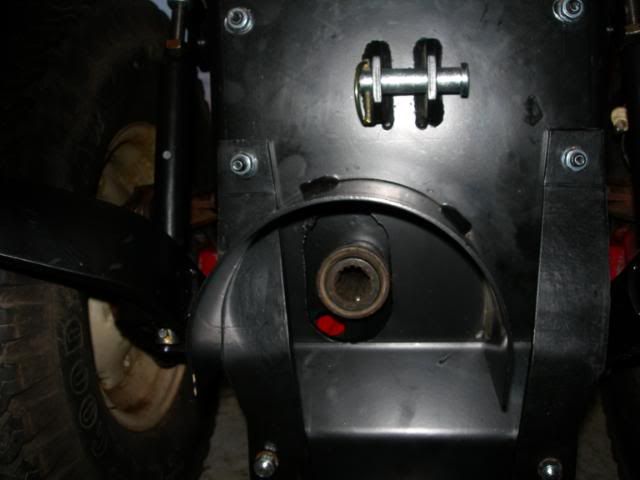

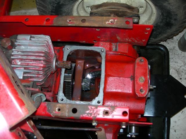

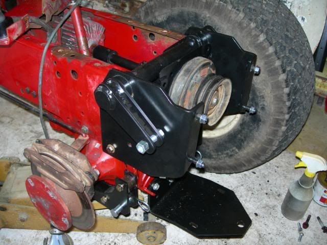

Just finished up for the day. Not because I wanted to, but ran into an issue.:angry: Here's the pics from today.
Removing the seat/fender pan
http://i133.photobucket.com/albums/q...tors/002-9.jpg

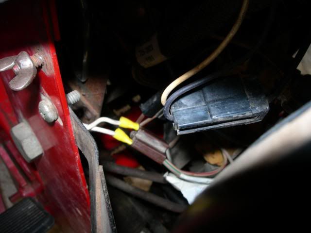

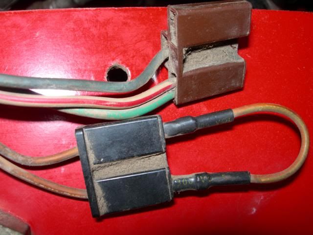

Test fit PTO and wanted to get it wired and tested.
http://i133.photobucket.com/albums/q...tors/003-8.jpg
http://i133.photobucket.com/albums/q...ors/004-10.jpg
http://i133.photobucket.com/albums/q...ors/005-10.jpg
http://i133.photobucket.com/albums/q...tors/006-9.jpg
http://i133.photobucket.com/albums/q...tors/008-5.jpg
http://i133.photobucket.com/albums/q...tors/009-5.jpg

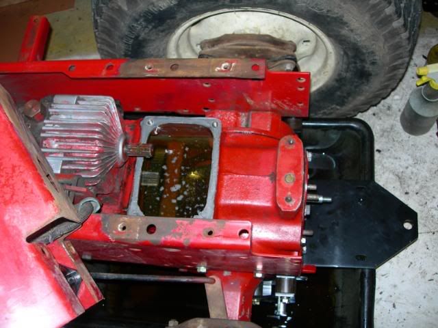

I found quickly that the plug didn't mate with the switch. I buzzed out the plug and found the appropriate wires and made jumpers to connect properly. Tested and works fine. It is actually a PTO switch and not a selector as in the instructions.
Drain rear end
http://i133.photobucket.com/albums/q...tors/011-5.jpg
Laid out parts
http://i133.photobucket.com/albums/q...tors/012-5.jpg
Installed
http://i133.photobucket.com/albums/q...tors/014-3.jpg
Easy way to fill
http://i133.photobucket.com/albums/q...tors/016-3.jpg
Filled
http://i133.photobucket.com/albums/q...tors/017-2.jpg

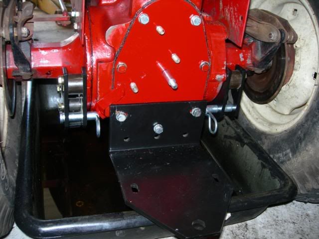

The problem
http://i133.photobucket.com/albums/q...tors/018-2.jpg
http://i133.photobucket.com/albums/q...tors/019-1.jpg
The holes aren't lining up. With the bolt in the axle tube, the upper holes are about 1/4" off. I'm going to make a pattern and see what I'll need to do.

Can you provide a pic of what's not lining up?
Scott
And yes correct on the pto switch, not a directional switch.
toyman 04-25-2010 07:52 PM
Got it all worked out. If you look at the 2nd to the last pic, you'll see the bolt that connects to the rearend thru the axle tube. (bottom left corner) I made a pattern off the frame and it showed that that hole (on both sides) was about 1/4" too high. All the others lined up fine. I marked and elongated the holes and it bolted right up. Now the next issue is the connection of the lift bar to the 3 point. The CC manual shows that there is a headless clevis that stays in place with a roll pin. This one comes with a nut and bolt, but they won't clear the bolts that connect the side plates on. I think I have a fix for that also. Right now I need a longer clevis to connect the lift rod at the cylinder, a way to connect the lift bar to the rear, and then torque everything down.

Snuck an hour in the garage after Dad duty last nite. Got the arms installed, the pto pulley, idler, spring, and the rear plate almost installed. Need to adjust the holes a little tonite for a better fit. I fired her up and worked the lift, and also switched on the rear pto. Worked quiet and smooth! :beer2: So, my final tasks: 1) elongate a few more holes on the rear plate 2) Replace the 3 1/2" gr 8 bolts with 3 3/4" gr 8 bolts in the rear end, right side 3) Retorque all the bolts 4) Replace a check valve that all of a sudden went bad 5) Replace the tins & seat 6) Install the SenTek Tach/Hour meter I got from Cabela's 7) Change the fluids in the tiller 8) Install the tiller 9) Give the garden a final tilling before I plant.
More pics to follow!

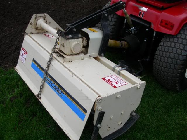

toyman 04-29-2010 07:51 PM
Last update on this thread. I'll start a new one when I start on the blower!
Put the tiller on and all I can say is WOW!
