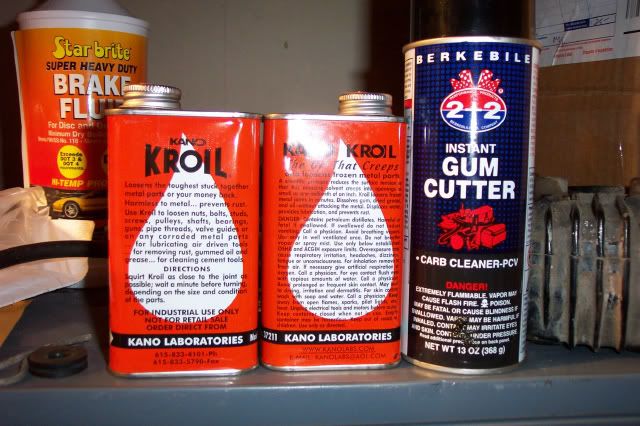

Did you blow compressed air thru the passages and use carb cleaner?
I highly recommend Berkebile 2+2 Gum Cutter. Nothing I've found works better for cleaning carbs.
http://img.photobucket.com/albums/v7...F.jpg~original
