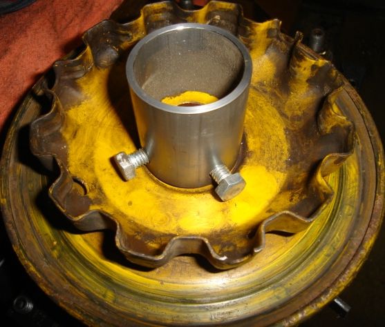

I made this funny PTO basket puller today out of an old drive shaft, some longer basket pulley set screws and a sledge hammer head. It worked fine. Alternated the puller from one screw to the other. I put the Allen head of the screws into the holes in case it broke off so I can get it out later. I may change the set screws to non hardened ones though.
Don't forget your safety glasses!!!
Please comment if you please.

BTW this was soaking for 2 days in PB so it kinda helped.

Did you leave the PTO arm in place? I could make a piece for the driveshaft to slip over the threaded collar so the basket pulley would be driven straight off.
I used a different approach to get my pulley off.
I made a puller and drilled the pulley for 5/16-18NC ( "F" drill ) The spacing also works for removing the flywheel.
http://img.photobucket.com/albums/v7...h_DCP_4979.jpg
http://img.photobucket.com/albums/v7...h_DCP_5319.jpg
By using two longer bolts with 1/2" sockets, it makes a great PTO bearing puller :biggrin2:
http://img.photobucket.com/albums/v7...DCP_4967-1.jpg

I would like to see if you can make a collar to fit over the part of the pulley that has the set screws, then drill 2 holes in it that would line up the the ones on the pulley, put a threaded end on the collar to fit on a real slide hammer.sorta something like that...
There are different sizes of bushings on the pto baskets though,so you would have to get at least the two sizes I have seen.

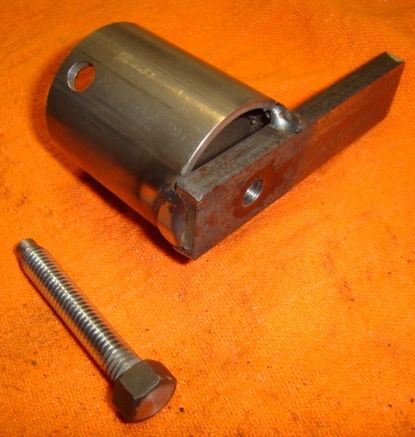

I made a little progress tonight :beerchug:

That looks great. Jeff are you going to weld a plate on the end with a nut in it? I was thinking to shorten it and do that so you could either use the lew slide hammer on it or if someone doesn't have a slide hammer they can thread a tapered end bolt in it like what's on a puller to push against the crank and if the pressure doesn't make it pop off a couple wacks on the bolt should make them go too. Just a thought.

Jeff in Pa 03-21-2014 07:34 PM
It's going to get a 5/16" x 1" bar welded to the open end that's drilled 3/8-16 for a bolt to push against the crank.

I lucked out on the material for this, it's the same material I use for Kawasaki 2 stroke street bike expansion chamber manifolds :biggrin2:

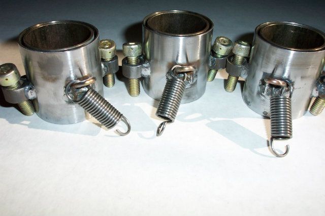

Jeff in Pa 03-23-2014 06:55 PM
How's this Lew? :beerchug:
http://img.photobucket.com/albums/v7...3.jpg~original
