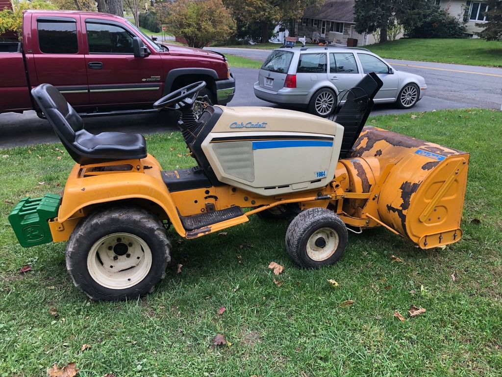

I see you got a new snow thrower, be sure you show some pics when you use it!
John147 10-20-2018 08:30 PM
Originally Posted by darkminion_17 (Post 469901)
Good for you, easy fix, not good for me as I am hungry.
Got any good hood's or side panels i'm sure i could still feed you lmao. i did get a new blower she looks a little ugly and needs a new chute but i'm hoping it serves me well.

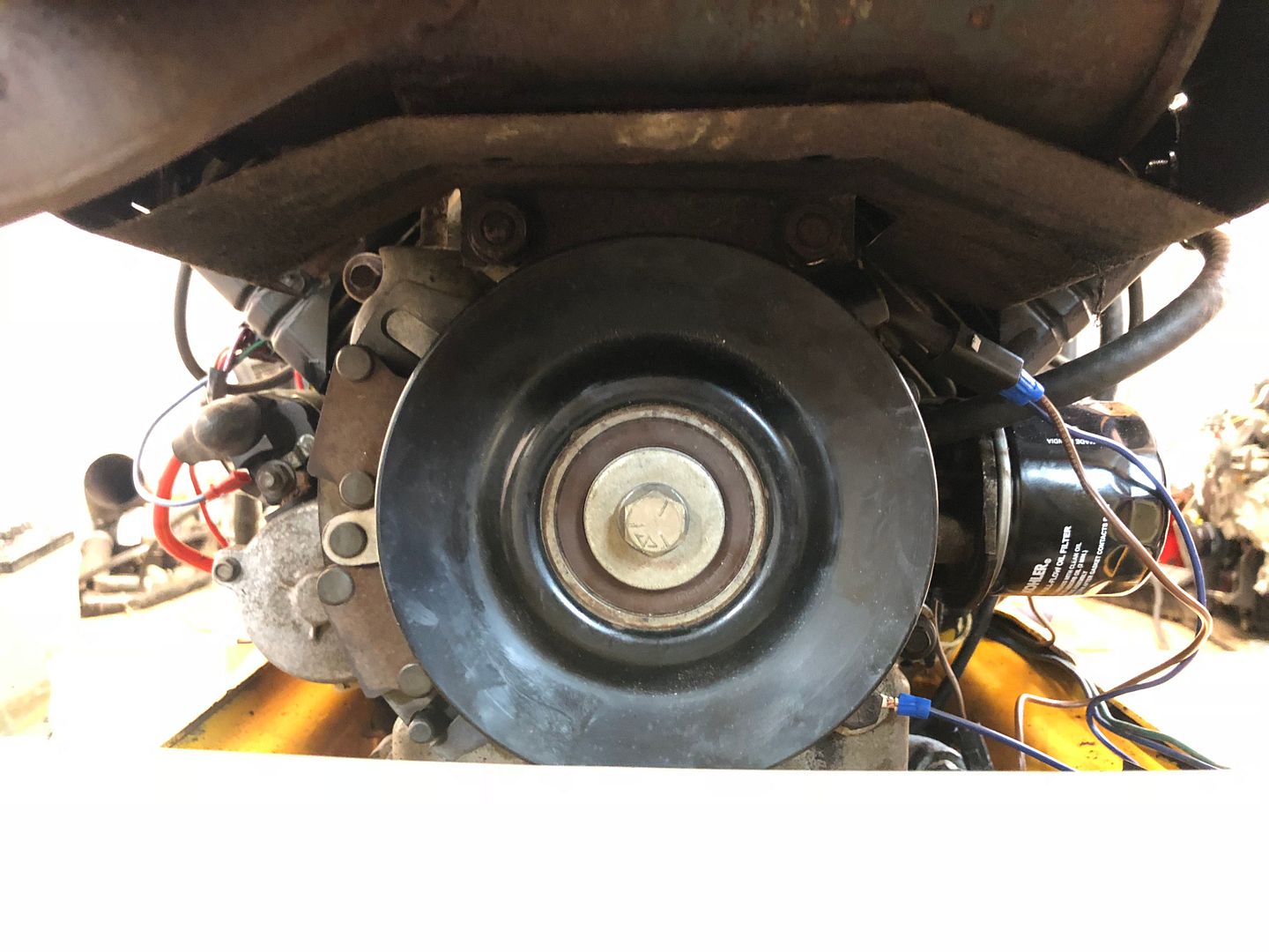

Well i'm still chugging away with getting this machine up to the running condition it would be in. The rear main seal was leaking so bad the PTO clutch magnet became so soft it was starting to regrade and the bearing was toast. I was at Lew's place and picked up a new style PTO and ordered the clutch stop and space from Cub cadet. I made a grounding harness and grounded it to the block and made a jumper from the tractor harness to PTO harness.
http://i200.photobucket.com/albums/a...psxxz0gdv1.jpg
I also started to service the transmission and replace the leaking axle seal and managed to kill the new seal because i forgot my seal driver set at work and tried to cheat and use a large socket that was to small.
darkminion_17 10-28-2018 11:54 AM
John,
Pto looks good, better than being in a box. Too bad about the seal, one place I know to find one was in Antarctica or the zoo....
This PTO came off a 2042, all he needed was the spacer and the stop .
Good to know if you are looking for a replacement for your one eyed wonder.

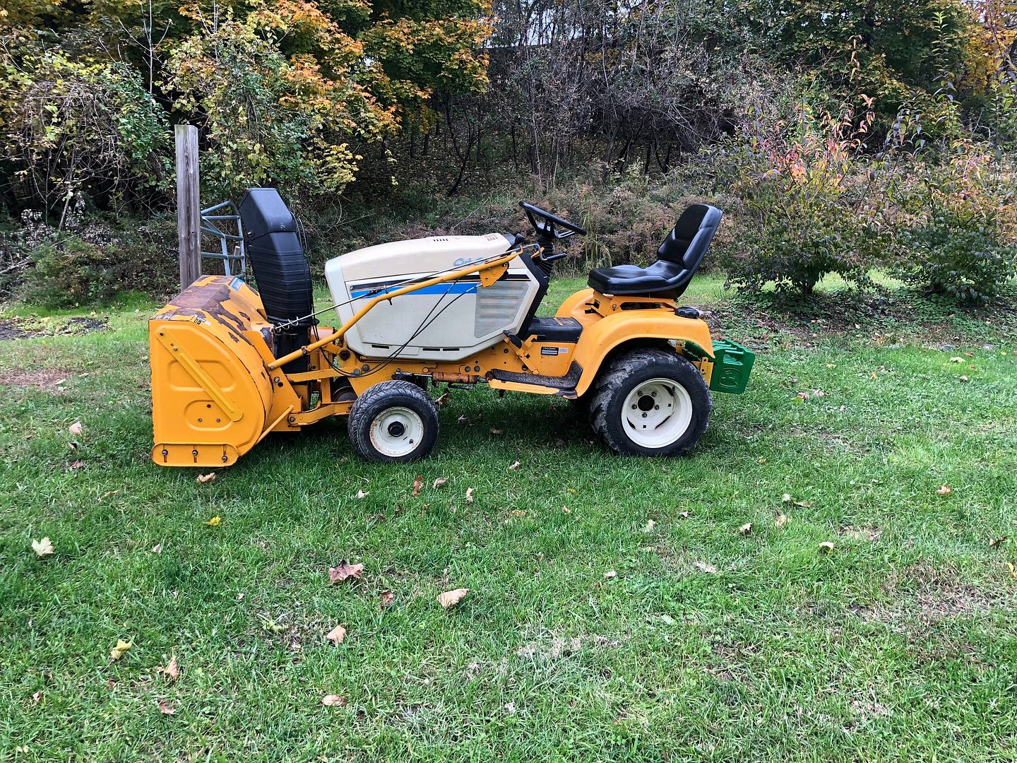

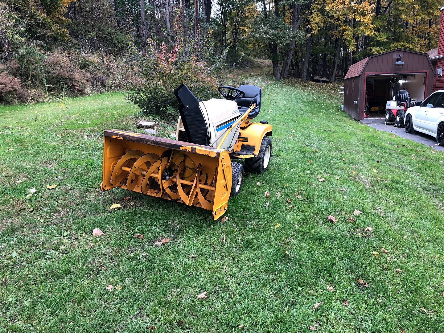

I finally finished servicing the 1864 and have it to the point it's ready to go for winter
http://i200.photobucket.com/albums/a...psb6l6seze.jpg
http://i200.photobucket.com/albums/a...psjin4ff7q.jpg
http://i200.photobucket.com/albums/a...psnsot93xu.jpg
cooperino 11-01-2018 06:38 PM
Call me jealous! Nice looking cub
John147 11-01-2018 06:57 PM
Thanks this is one i've always wanted
