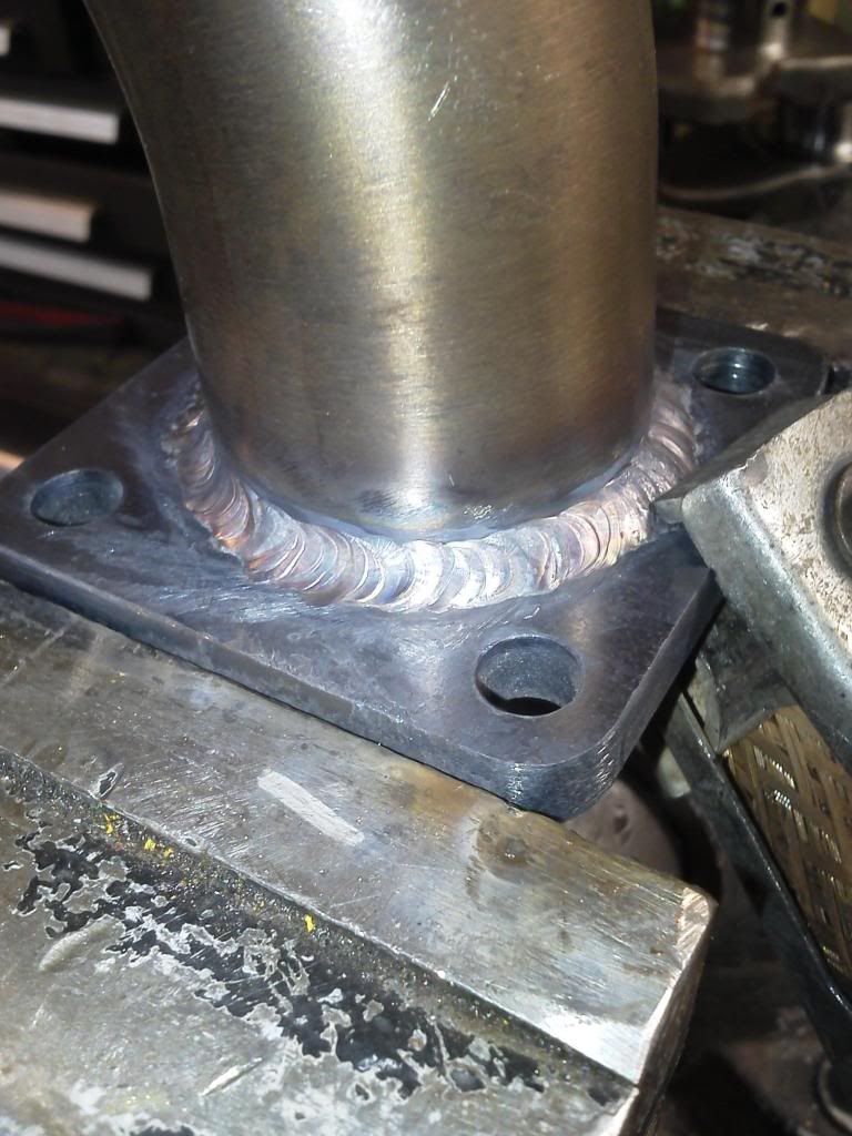

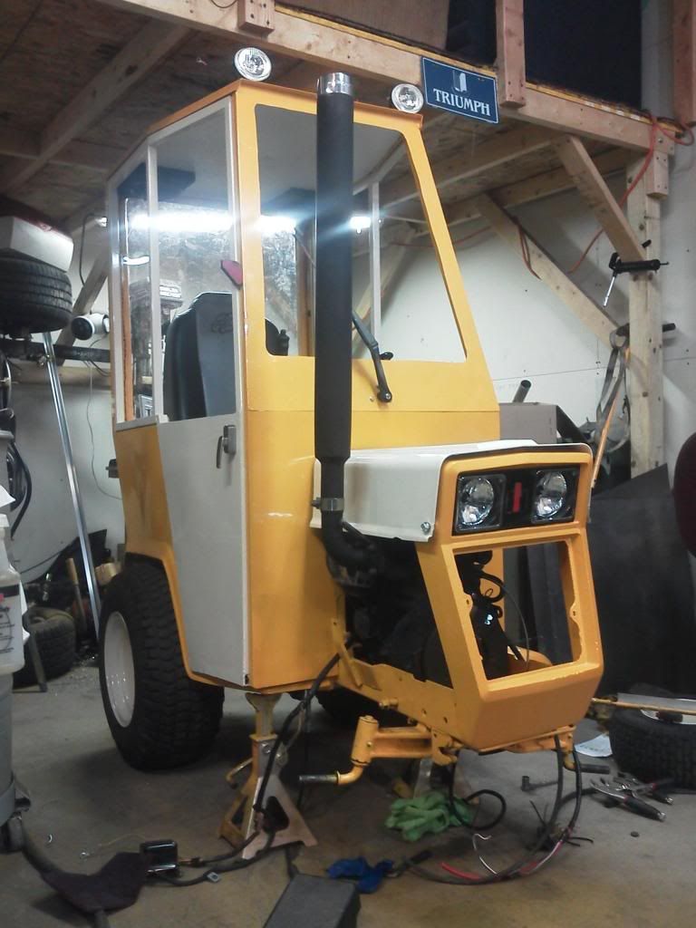

Exhaust
I got the exhaust built tonight. Started with a 2-1 pipe off of a harley bagger, then took a harley bagger slip on and cut off the inlet and welded it to the cut off muffler from the 2-1. Then welded up a elbow and gusset on the flange I made. Muffler loosely installed in the photo and that is the reason for the lean.

Methos 11-08-2012 02:46 AM
Now that's a stack! Looks to be braced as well.:beerchug:
xtreamedrtbker 11-08-2012 03:18 AM
Yeah it is braced, made it good and stiff. I wanted to get the fumes up as high as possible. No one wants to choke on black smoke.
ACecil 11-08-2012 02:13 PM
Great pics! The stack is pretty cool!
4SPEED 11-08-2012 06:20 PM
Ataboy.. nice work....
zippy1 11-09-2012 01:50 AM
Very nice craftsmanship:beerchug:
Also very clean, and well thought out project.
Shaner 11-09-2012 03:09 AM
If visibility ever becomes an issue you could always route the exhaust out under the cab.
xtreamedrtbker 11-09-2012 11:40 AM
Thanks guys!
I was going to originally go underneath with the exhaust, but the friend that I got the engine from wanted to see the thing puff a little black smoke, so I figured a stack was a must. I am really looking forward to getting this thing up and going. Snow will be here before I know it.
