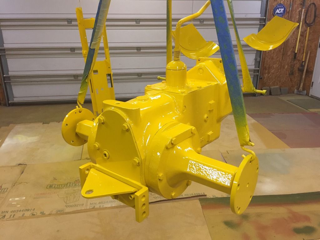

IHinIN 04-17-2017 09:40 PM
I literally blew the cobwebs off of this project and layed down some yellow paint tonight.
http://i934.photobucket.com/albums/a...psc9cd3rgn.jpg
olds45512 04-17-2017 09:44 PM
Glad i could help motivate you, keep up the good work.:beerchug:
Dirty Steve 04-17-2017 09:47 PM
Looking real nice! :beerchug:
ACecil 04-17-2017 09:52 PM
The new yellow is looking good, Adam!
