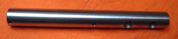

Originally Posted by Jeff in Pa (Post 255058)
You'll be fine Chris
Here's the double drilled lift pin I make
http://img.photobucket.com/albums/v7...7.jpg~original
It will work just fine :beerchug:
Jeff
As long as the threaded end of the chain lift can go through it, which I'm sure if you are manufacturing them and have been for some time, it'll work great.
Sugarmaker 04-17-2014 09:50 PM
Oh! that shiny new pin looks nice! When the pin gets here I think I have all the parts now. Might need a couple longer bolts for the rear bracket and a washer for the tension-er on the mule drive.
May be able to get this tiller on a tractor this weekend.
I will try to take some pictures.

Jeff in Pa 04-18-2014 09:42 PM
Regards,
Chris
USPS tracking shows it delivered :beerchug:
I've been able to get the correct belt tension with the nut by turning it in about an inch.
Sugarmaker 04-18-2014 10:09 PM
Jeff,
Got the new pin! Very nice! Will get some pictures as we get the tiller attached tomorrow.

Sugarmaker 05-28-2014 09:26 AM
Jeff,
Thanks for the recipe for the pancakes!
I made a couple slight mods to your lift pin. I added another through hole for a coter pin 3/4 inches out from the cross holes. This allows the pint to enter the sleeve hitch farther. Down side is that I had to grind off a chamfer on the end going through the sleeve to allow clearance for the pivoting of the pin to clear the case. These small mods allow the tiller to be lifted a little higher.
Also added the spring assist the I got from Cub Crazy. Thanks Mike! That makes it easier for the old man to lift this beast.
Went to the garden and started tilling. grass had taken hold and I had not plowed so this was the first pass. Man I thought it really tilled hard. lots of bouncing not much action. I made about 8 rounds and was down about 2 inches in the soil. the tiller stopped so I drove up to the house to check it out. Seems the belt tightened from the 90 degree drive to the tiller had loosened up. While adjusting that I turned toe tiller on and looked at the blades. THEY WERE ON BACKWARDS!
PO must have put on new blades and the tine assemblies were reversed. Now have them changed around (just swapped sides) but havent tried yet. Should work better.
No wonder my daughters boy friend wasn't to impressed with the tiller for their garden:)
