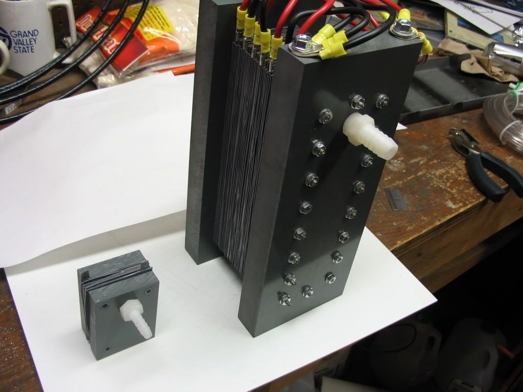

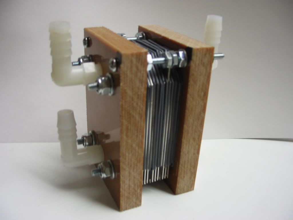

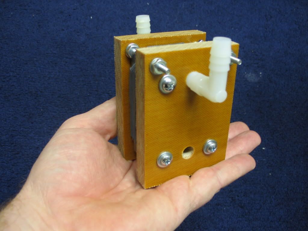

I built a mini generator that I wish to install on my Cub.
Here is a pic.
http://i212.photobucket.com/albums/c...nerator024.jpg
http://i212.photobucket.com/albums/c...nerator027.jpg
http://i212.photobucket.com/albums/c...nerator029.jpg
http://i212.photobucket.com/albums/c...nerator004.jpg
I haven't had a chance to install it yet because I am working on bigger designs but am curious how the Kohler will run with a good boost.

They were actually bad designs. Took too much amps like 25 amps and got half a liter/minute of hydrogen production that won't cut it. If i can't get 1 liter/ minute per ten amps with a PWM then I'm not maximizing the current load per hydrogen production. Might as well keep the vehicle stock.
The pictures you see is a "dry cell". A dry cell isn't submerged in water like the traditional "wet cells where the plates were dunked in a reservoir of water. which wasn't precise in production because of bumpy driving conditions.
The dry cell isn't submerged hence the name "dry cell". It has a water reservoir above it and circulates water on it's own with less amp draw. They are more expensive to make but it's a better design. The one you see has laser cut plates...I know someone with a laser...LOL!
Really, there are the "good the bad and the ugly in designs out there. You have to find the good one!
Chase
