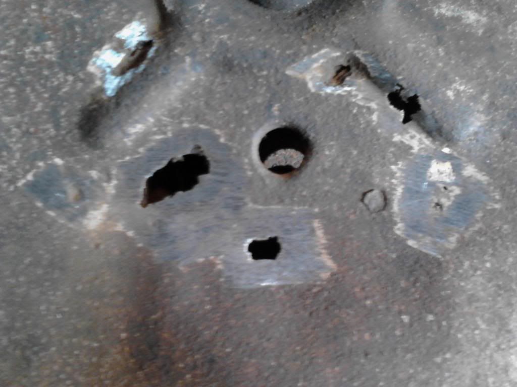

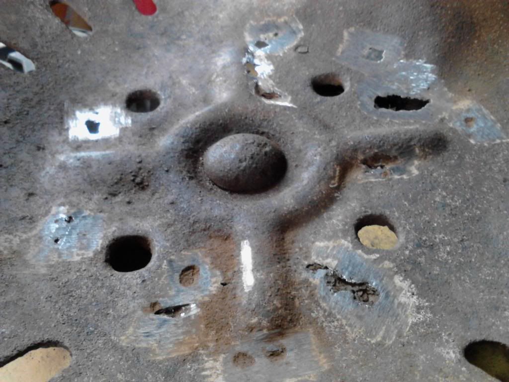

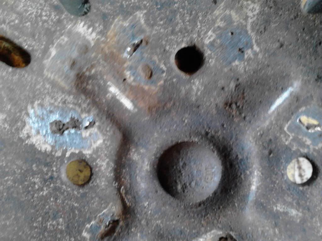

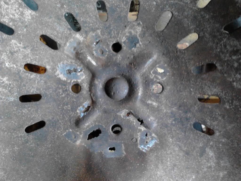

IsaacSchuler 03-22-2014 09:11 PM
http://i1000.photobucket.com/albums/...psc8fe924d.jpg
http://i1000.photobucket.com/albums/...ps31edfeb5.jpg
http://i1000.photobucket.com/albums/...psd37e7519.jpg
http://i1000.photobucket.com/albums/...psb0bb7896.jpg

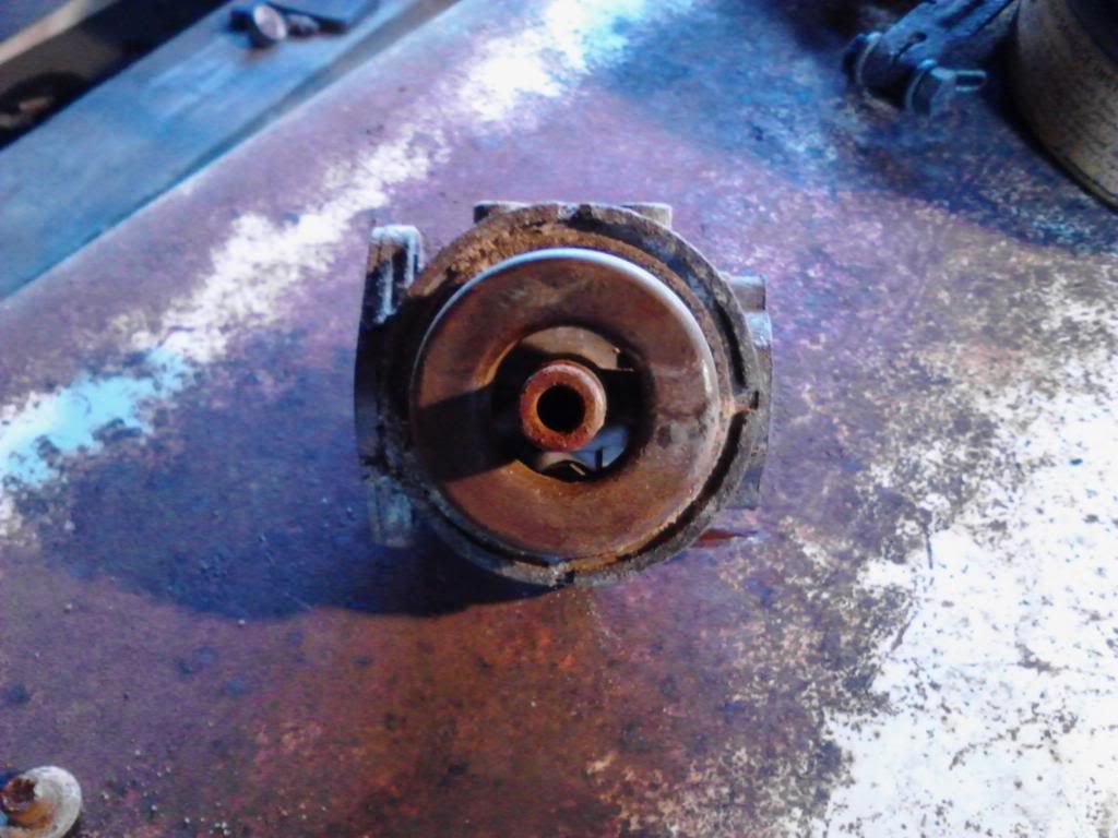

IsaacSchuler 03-25-2014 02:32 PM
http://i1000.photobucket.com/albums/...ps609c5878.jpg
Got the carb soaking in kerosene

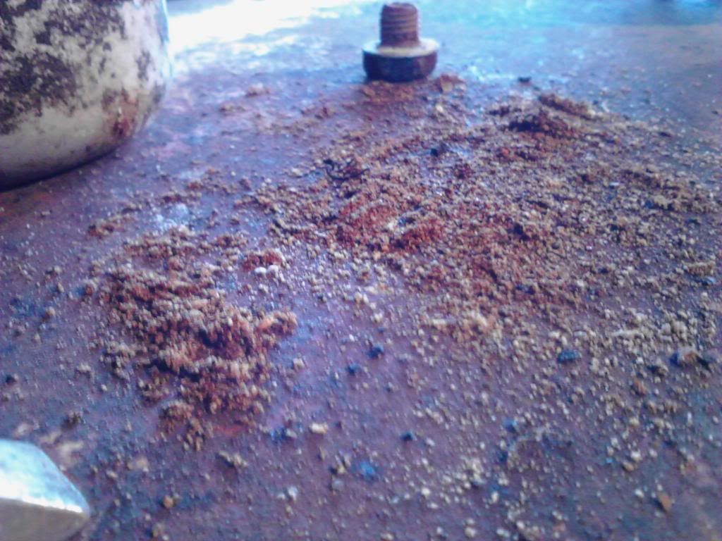

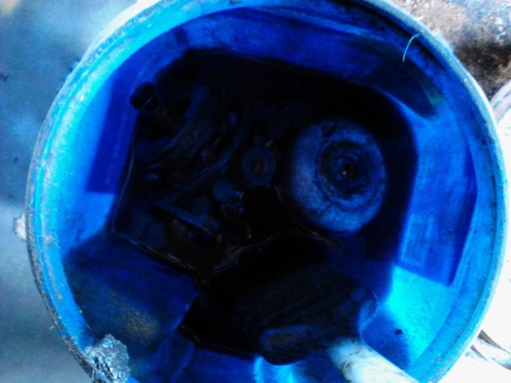

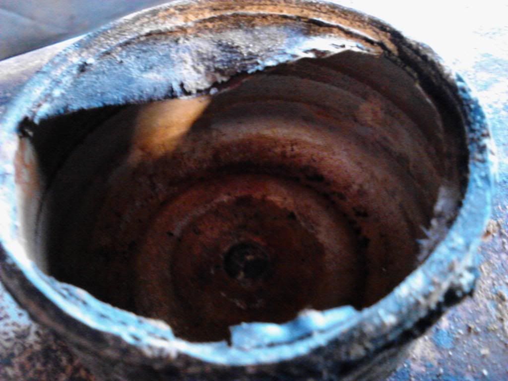

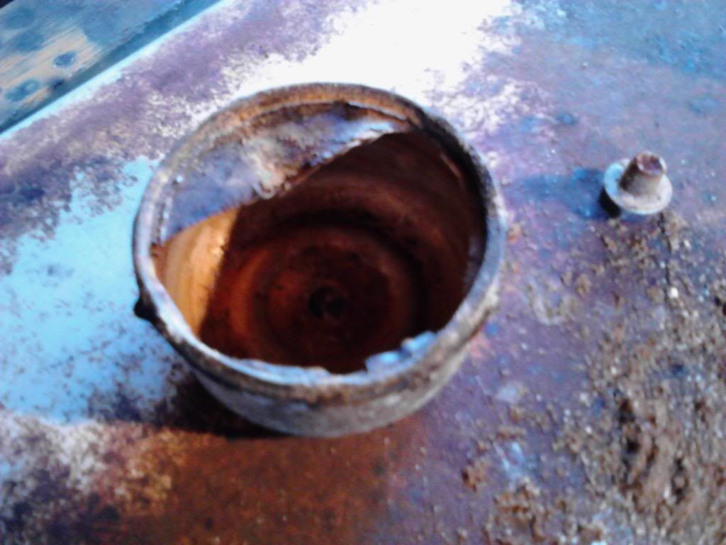

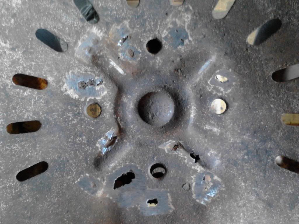

IsaacSchuler 03-25-2014 02:34 PM
http://i1000.photobucket.com/albums/...psc1abf33d.jpg
http://i1000.photobucket.com/albums/...psda91ecac.jpg
http://i1000.photobucket.com/albums/...ps915bfc09.jpg
http://i1000.photobucket.com/albums/...psf007606f.jpg
http://i1000.photobucket.com/albums/...pse8510f68.jpg
Got the holes cleaned up now i'm going to try and fill them in with weld.
