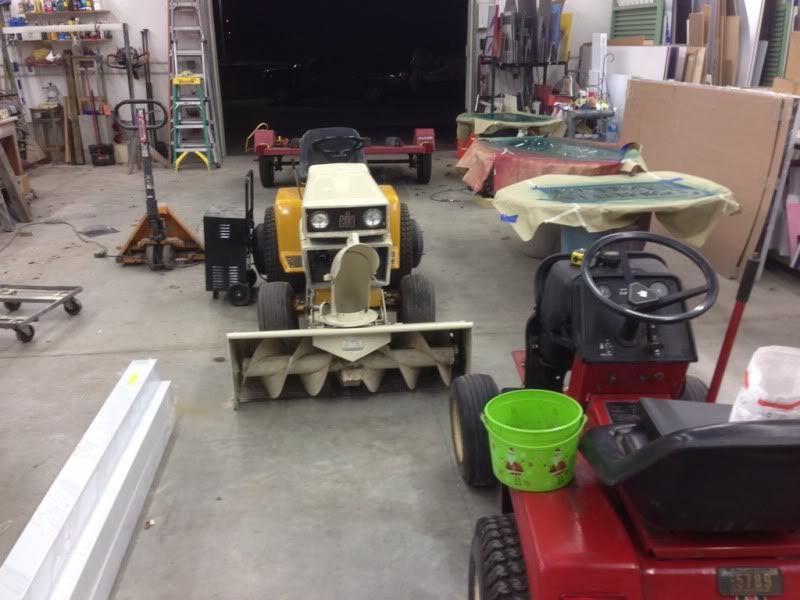

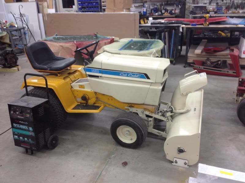

Daddysignman 12-05-2012 07:21 PM
Well after a long fight my 1450 is put back together and running good. I had my buddy tell me my carb was shot and I needed a new one. He said the throttle shaft was shot! So I went to Ace and got the brass thrust bearing and two new screws and schooled this 30 year veteran of tractor repair. He owns the largest John Deere dealership in CT!
He was amazed that fixed it!
So I brought it home and put her back together.
http://i109.photobucket.com/albums/n...80AD07DC5A.jpg
I machined a couple of polyphenelic plastic skid plates for the snow thrower so I don't scratch my new driveway.
I power washed and painted the QA42A the other night and threw it on. I tried using the belt off the 582 but it doesn't fit. Anybody know which size belt I need off the top of their head?

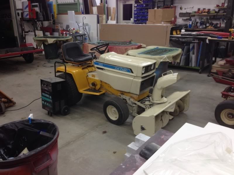

Here's a few more shots. Tomorrow I will make the new graphics and get them installed!
http://i109.photobucket.com/albums/n...80A768F54E.jpg
http://i109.photobucket.com/albums/n...80A498683F.jpg
