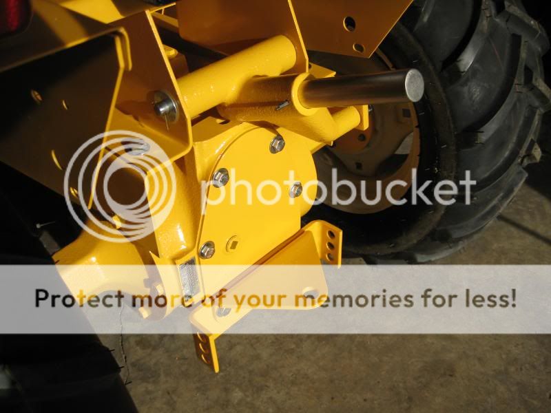

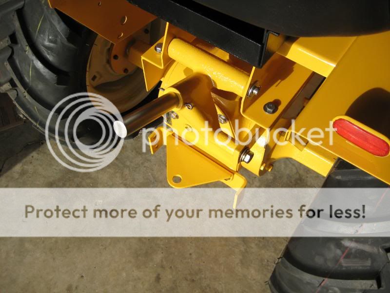

I haven't had much time to work on it lately. I did manage to get the hitch blasted and painted.
I made the lift rod out of stainless. I still need to drill the pin hole.
http://i959.photobucket.com/albums/a...r/IMG_3982.jpg
http://i959.photobucket.com/albums/a...r/IMG_3983.jpg

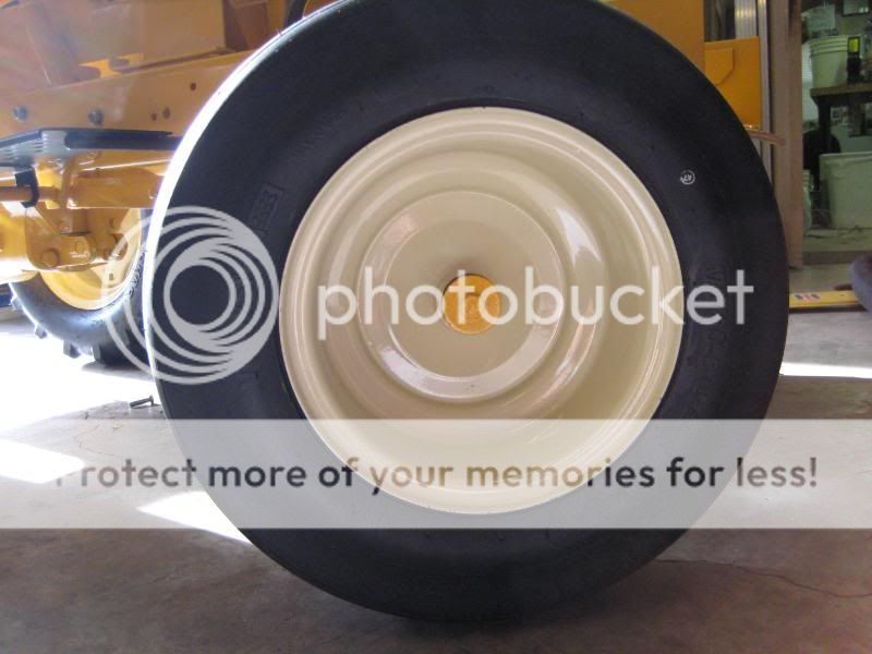

The original front wheels had the valve stem on the outside. I welded that hole shut and installed them on the inside for a cleaner look.
http://i959.photobucket.com/albums/a...r/IMG_3984.jpg
