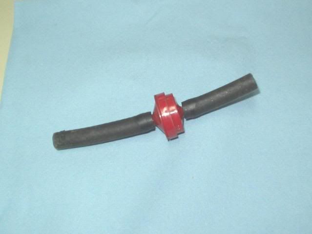

All my small motors have a filter on them. I don't rely on the screen that is in the gas tank. I will use a sediment or an inline fuel filter along with the screen in the tank.
My Son came home with this filter when he worked at a small motor shop:
http://i152.photobucket.com/albums/s...asfilter01.jpg
This is on my 149.

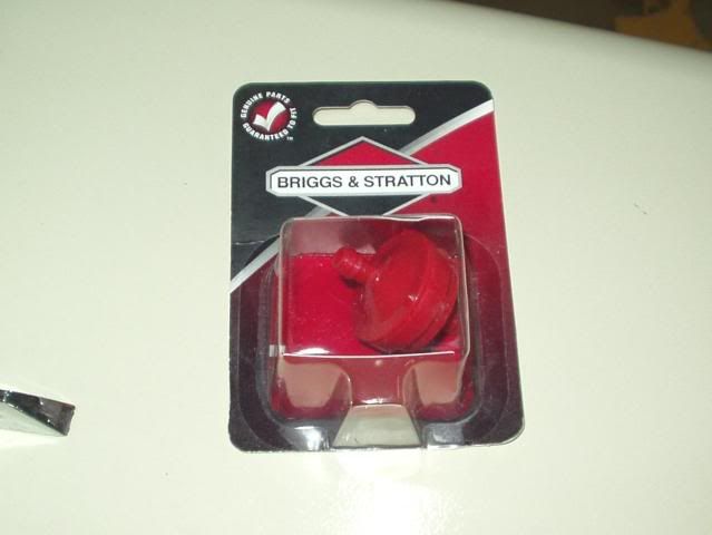

I have used this filter from Briggs and Stratton in the past.
http://i152.photobucket.com/albums/s...asfilter03.jpg
It doesn't take that much space:
http://i152.photobucket.com/albums/s...asfilter04.jpg
The part number is 5018.
