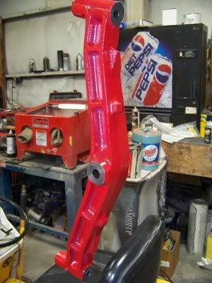

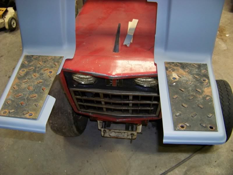

also got this set of tred plates from a 145 ( maybe? ) its a hydro. guys is parting out. the tins on it look really good.
I'll need to cut a little on one of them and add a bolt hole. but they should work.
http://i846.photobucket.com/albums/a...t/100_6995.jpg
another part ready to go back on
http://i846.photobucket.com/albums/a...t/100_6996.jpg

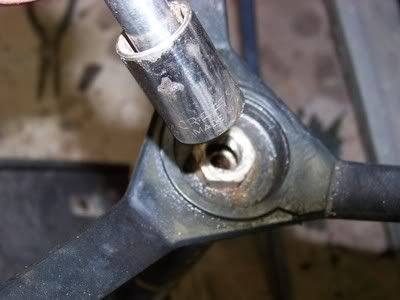

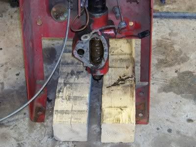

How I took the stearing wheel off
I took the stearing column off , took off the end cap and bearings. set it on 2 blocks of wood. then took the nut loose (keeping a full nut), took a 3/4" socket 1/2" drive extension bar. put the socket on backwards and gave it a smack. it came off on the 3rd blow. had it socking in PB blaster for 2 days too.
http://i846.photobucket.com/albums/a...t/100_6999.jpghttp://i846.photobucket.com/albums/a...t/100_7000.jpg
http://i846.photobucket.com/albums/a...t/100_6998.jpg

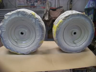

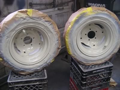

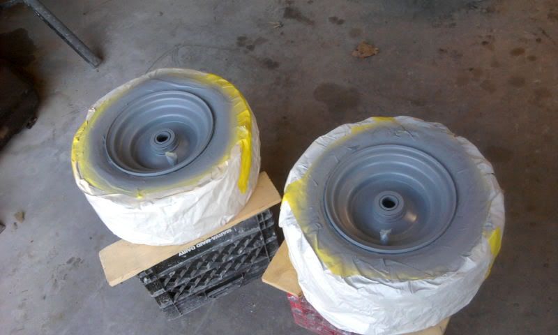

Painted Wheels #902 White
Martin Senour paint code 99-10649-L #901 White
http://i846.photobucket.com/albums/a...t/100_7001.jpghttp://i846.photobucket.com/albums/a...t/100_7002.jpg
