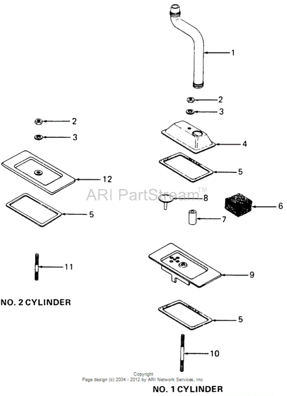

I am new to these M18's also. When you say breather which part are you talking about, part # 9? What should I look for? How do you know if the filter is good? It may be obvious, but I haven't gotten that far yet. Since it has been mentioned, I just thought I would ask.
I actually have two of these engines now. One runs great, the other is blowing oil from the breather tube.

Oak 01-11-2012 10:47 PM
Chip, I think they re-designed the #1 breather IIRC when I did my mag. I will see if I can find some pictures.
Vince_o 01-12-2012 05:39 AM
# 8
Mine was just laying in there not in place, and that little filter was MIA. I'll post some pics from work today as all the rebuild pics are on that computer.
