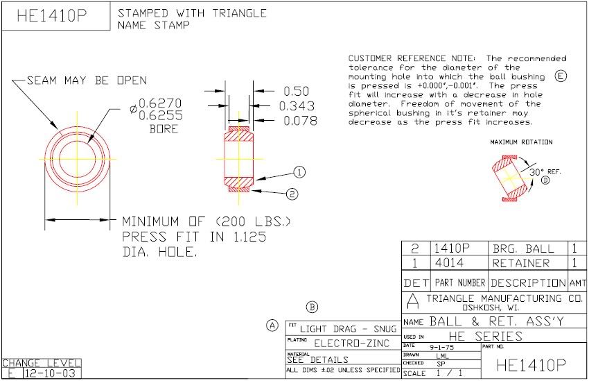

Now my question is about the pilot hub bushing. I pulled it out and it has some side to side play in it. I want to replace it but it cost $26.00 from cub cadet. I think I could find it cheaper somewhere else as I found the company that makes it. But can it be replaced with a bearing? And if so where can I find one.

Your dealer gave you the wrong price. You can order direct from the company that makes them for that price range tho. I think there is a min order that has to be made.
I don't think a bearing would work in it's place as how the bushing ball has room to move. It aids with getting the motor mounted to the drive shaft and it allows some movement once it's installed.
Old 01-22-2012, 08:24 PM
The minimum order from Triangle Mfg. Co. is $30, IIRC. That'll get you about 15 of those ball bushings. It's really sad that CC marks them up over 1000%.
Whatever you put in there really still needs to account for engine/trans misalignment.
